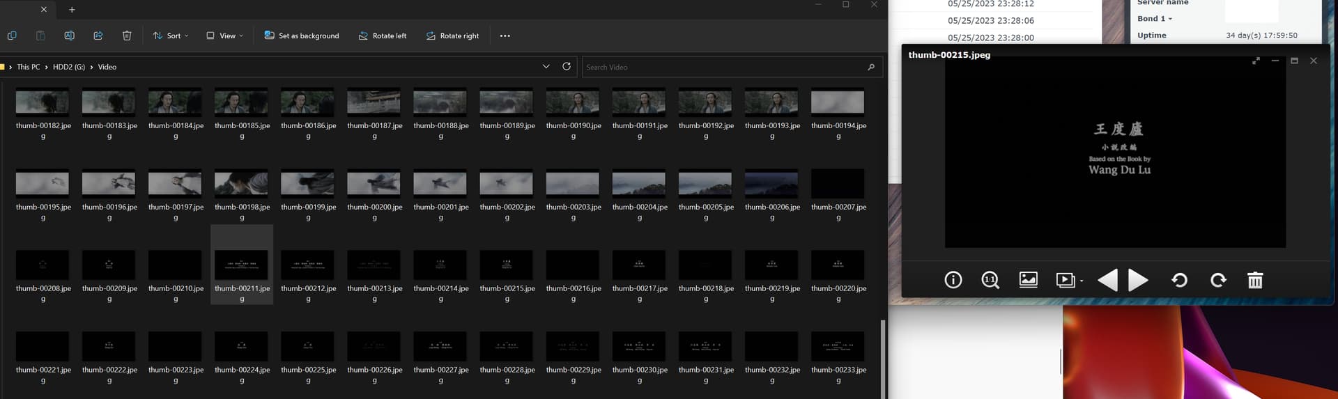

In each case, the Scanner will fail at almost exactly 30 minutes to the T for each movie. Before the failure, I can see the Plex Scanner process writing to the Plex /tmp directory a batch of thumbnails of the movie. In an example movie, Crouching Tiger, Hidden Dragon the Transcoder within that half hour will create approximately 230 thumbnails into the /tmp directory before the process stops and the /tmp directory is dumped. If I run the same command Plex is executing on a Windows system running ffmpeg, ffmpeg will without error, create 361 thumbnails to my working directory and exit.
It seems the problem may be due to some sort of Watchdog or Timeout inside of Plex, caused by the fact that the slow Atom CPU in the NAS isn’t able to process HEVC video footage on a single core very quickly. Plex seems to limit this background detection to a single core as well, whereas it could probably finish if it were allowed to use more resources. When I run the same operation on Windows, I gave it an entire AMD Ryzen 5800X3D to decode the video, and it was able to complete the operation within a couple of minutes. I do not have issues with any movie that is H.264, VC-1, or MPEG-2 Encoded in 1080p.
In the above screenshot, I’m simply showing the ffmpeg output that occurred on Windows. The NAS made it to the file that was selected before the Plex Credits Detection ended for the movie, and the /tmp directory was dumped. In every case, the exact error is: [CreditsDetectionManager] BufferingLineReader: failed to read line (error: -2)
