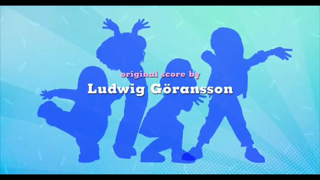

This movie have non standart (not black and white scene) credits so maybe could be other issue with detection problems? So maybe the algorithm try to detect credits but fail multiple time to do so and next maintenance time do this again and again…
Credits example:
