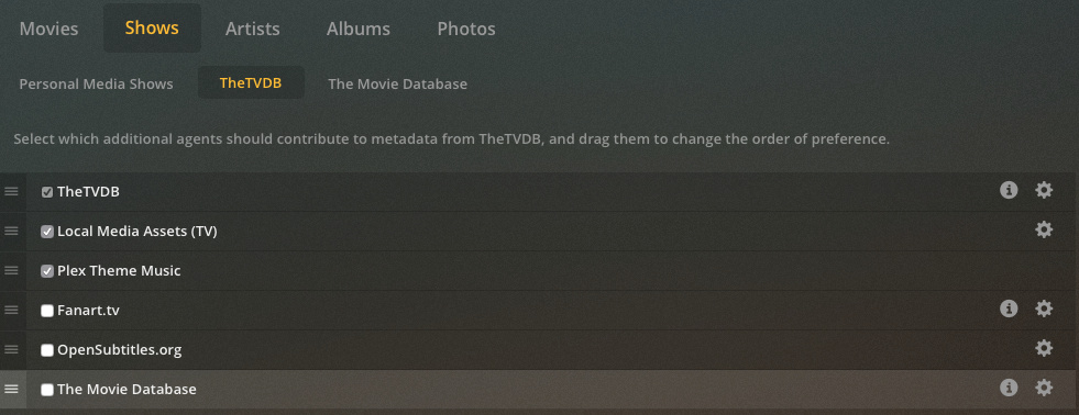

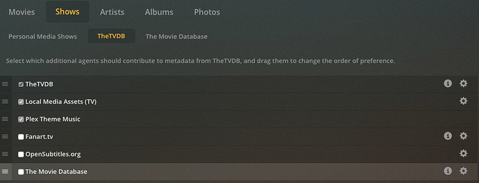

I just tested here, both with TMDB disabled and enabled for TheTVDB agent. With TMDB disabled, it detected as s00e100 generically, with no metadata. However, with TMDB enabled, it detected it as the OP describes (ignore the thumbnail, I used a re-named Jellyfish sample for the test):
So, it will pull the episode info from TMDB if you have it enabled as a source for TheTVDB agent.
For comparison, here’s how it detects with TMDB disabled:
