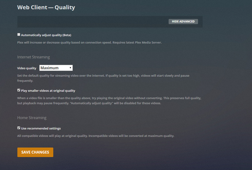

It may not make intuitive sense but if your server is local and you use the “use recommended settings” it will play videos as orginal on your network (unless they need to be transcoded for compatibility)

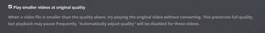

if the server is remote you can set the quality to maximum and then make sure this box is checked:
That will play anything below maximum as original. I am not sure what they classify maximum as the next lowest is 20mbs 1080p so i assume its higher than that so anything less than 1080p 20mbs will not transcode the video and play at original quality when connecting to a remote server
