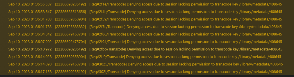

[Req#18c0/Transcode] Denying access due to session lacking permission to transcode key /library/metadata/408645
Greetings!
Today I’ve started noticing my console logs being flooded with the warning message above. Nothing appears to actually be wrong/acting up but seeing the error is a bit alarming.
The message appears every 3 seconds or so. I have confirmed the item in question via the 408645 ID. It’s a TV show which I can confirm is not being actively streamed but was recently.

Hey ChuckPA! Thanks so much for the follow up on a weekend (plus your awesome DB repair script)
As a typical quirky issue goes I woke up with morning to check the console and there was suddenly no trace of the warning message!
I’m thinking the 2-5 Maintenance may have ended up doing your suggestion 2-4 which most likely was the fix. (I swear I tried those but happy to see it gone :smiley: )
Thanks again for the assistance!
