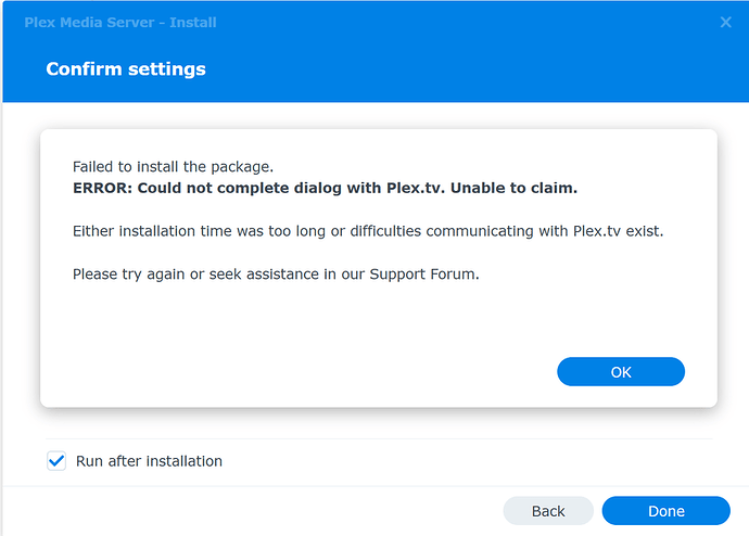

but the installation window is giving me this: (this was happening earlier as well)

Ok. I’ve got plex working on the synology. Upon turning on the vpn, when i reinstalled plex on synology it didn’t ask for what type of install… it just installed it. when i opened the plex media server, my server was already mine.
