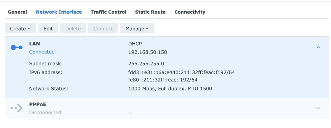

  1. Control Panel - Network - (now look at the network adapters)
  2. They should be “automatic” like this -
  1. Or manually set like this -
I suspect you are using the manual (static) method?
Does it point to the correct IP address (your modem/router) ?
I’m definitely using the automatic method, and it’s connected, as far as I can tell…
