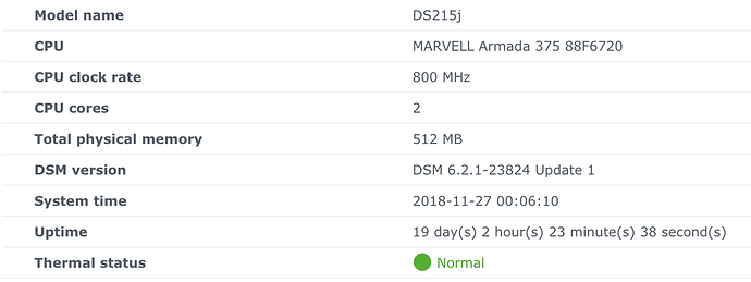

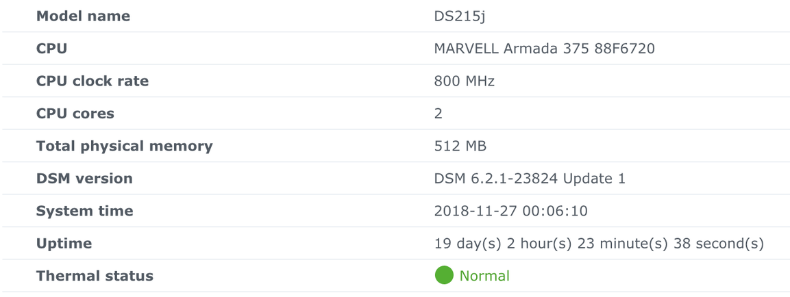

Same issue here 2 updates ago it started. Synology NAS
