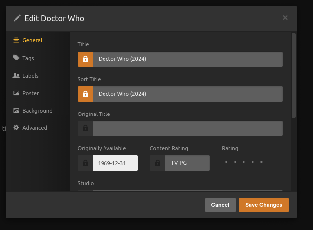

Same issue with the new Doctor Who (2023) - poster etc all good. ‘Originally Available’ 2023-12-25.
No episode metadata except ‘Originally Available’ which is greyed but has ‘1969-12-31’
So something isn’t right.

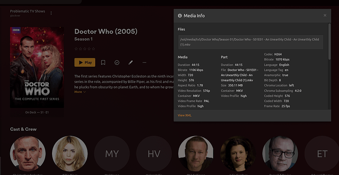

Take a good look at the Plex media info XML and the guid’s.

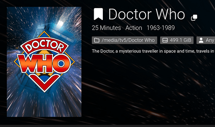

  1. Doctor Who [ original series → Doctor Who (1963) ]
  • Using TMDB → I get “Doctor Who (2005)” matching :x:
    – (NOTICE: I do not have the year nor should I need it )
  • Using TVDB → Same problem

My Doctor Who (2005) , which is TheTVDB, looks like this.
Is this much correct ?

This looks to be the problem ?? This new series is available 1969 ???
Screenshot from 2024-05-18 16-41-20
