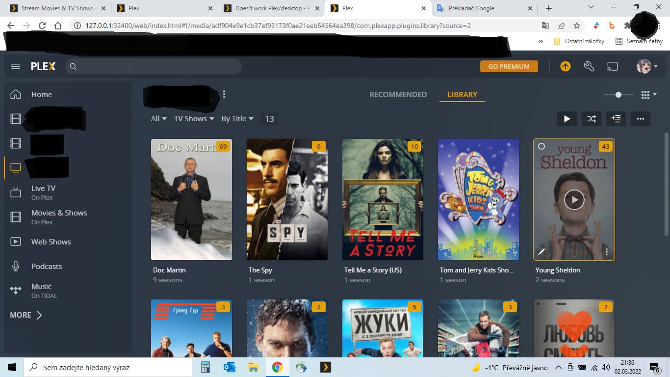

The first photo - it opens when I just try to open the plex, by the way my parents just have a white screen.
The second photo - it opens when clicking on your link.
Yes it’s mine home screen, mine desktop.
OK from the second screenshot click on the wrench icon on top right to get to settings. Then under your server name hit General. Does it show you as signed in there?
