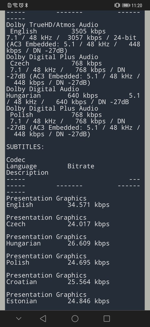

It means that 4k max can play Atmos sound this movie
And this codec format can’t be played with atmos
