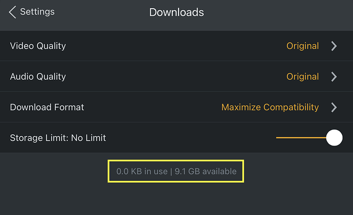

Did you have a Storage Limit set in the Plex for iOS Settings for Downloads ?
I have it as “No Limit”
…but I have 10G available on the iPad, so with 2001 a Space Odyssey being about 8G Original, space on the iPad was tight for that test d/l.
With that said, The New Downloads is now working for me.
