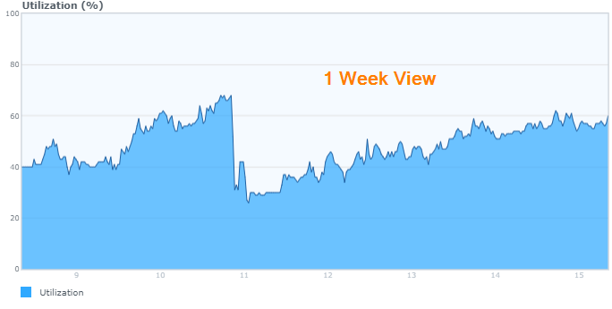

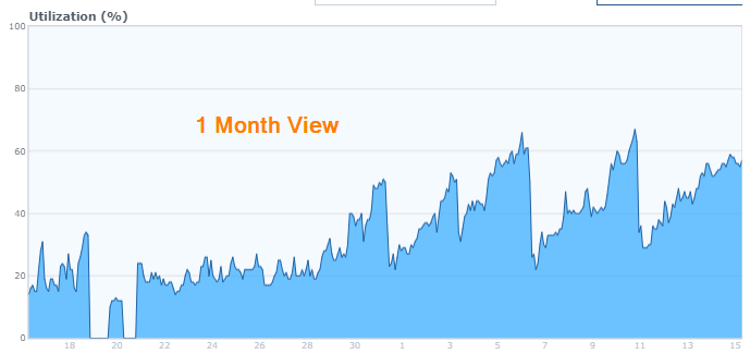

Noticed over the last 2 weeks or so that there seems to be a potential memory leak with PMS. As you can see in the attached images there is a gradual climb in RAM utilization and after I manually restart the Plex Media server application RAM goes back down to normal levels. Before I noticed this, RAM would spike periodically during trasncoded sessions but would then return back to normal levels.
Any else seeing this on their Synology servers?

Nice graphic but I need more to go on than just that please.
What changed?
  1. PMS version?
  2. Media being played (Codec)?
  3. DSM Updates?
  4. Other apps added?
Please expound
Only thing that has changed is the PMS version, no updates to DSM, this happens irregardless of media being played or not, and no other apps were added.
At minimum, I need to see the log files, and know which version you were running.
Not sure which log is the right one, attached the whole download. Server Version#: 1.13.9.5456.Plex Media Server Logs_2018-11-15_12-13-02.zip (3.8 MB)
