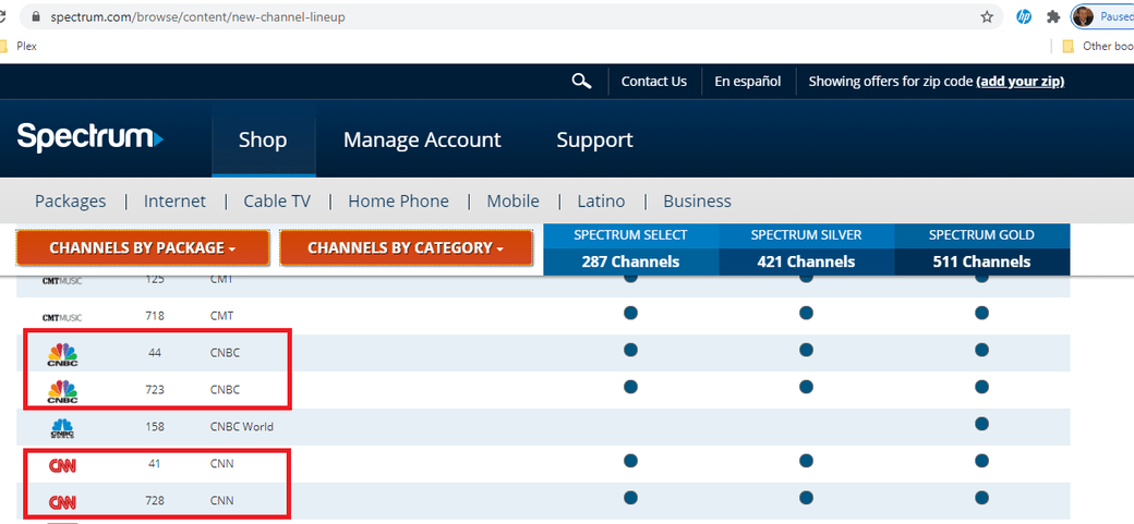

I do see a lot of duplicated channels on the Spectrum cable lineup. In fact they also show duplicate channels on their list of channels https://www.spectrum.com/browse/content/new-channel-lineup
(but for some reason Golf is showing there as 38 and 768 and not 315)
In their list the duplicate channels appear the same and not SD and HD - but both showing as identical channels

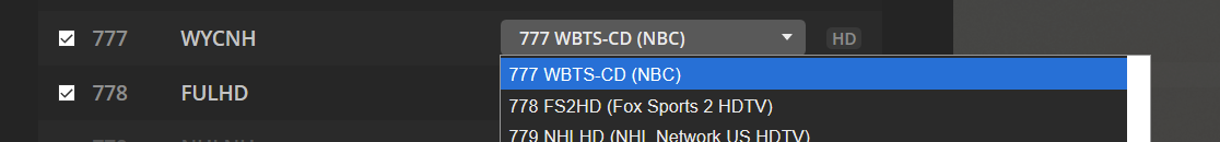

Do you have any evidence that they are SD and HD - if they are, then lineup would need to have them as separate source channels internally and so not end up with duplicate
We cannot handle a channel appearing on more than one number

The thing is, when choosing the channel information it does show a different number for SD vs HD, which one would think means that Plex realizes that they are different distinct channels. See below:

My guess is that the information our provider had for the channels did not distinguish between SD and HD for some channels - in fact the Spectrun web site does not
I will need to refer this to our provider to get the SD / HD channels separated into different titles. Some appear to have already been done eg CNBC and CNN - which show the same here
but are actually split into separate channel names in the guide data
