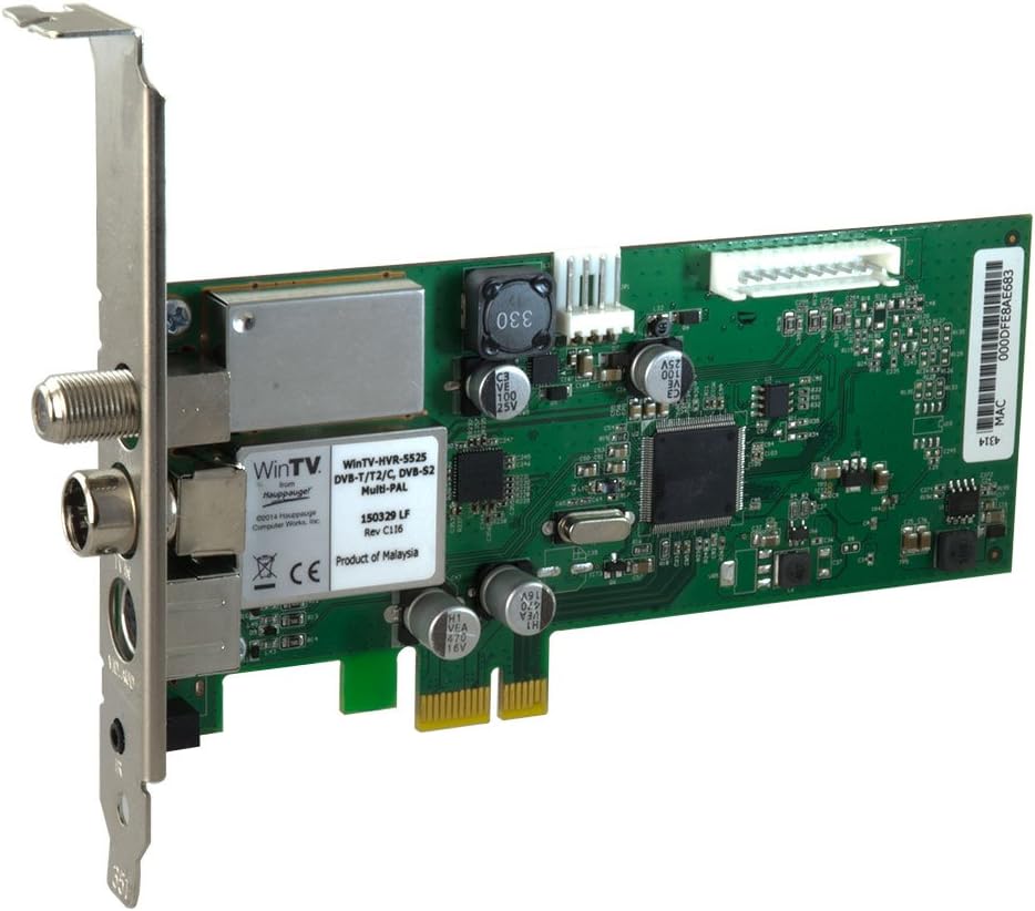

But it is possible to import EPG data into Plex? Also, yeah, I just ordered a Happauge device (same one as the one I already have, but the one I have supports DVB-T or something only, whereas the one I ordered for 102Ā£ supports DVB-T and S/S2 e.t.c)
So, I looked into it, and apparently yes, tvheadend is linux and such, it would be so OP if there were a tvheadend/dvb media server like solution that worked on an android tv, that way I wouldnt need any tuner card at all lmao
So once this pcie tuner arrives, hop in my LNB (which I guess my cable is LNB as the Top cable in the PCIE tuner, is the same connection type as my cable)
So I then set it up with DVB Media Server (Windows) and then link that to Plex somehow? Alrighty lol

Back again, so I have the tuner setup and the bundled software is working, I can see the channels, but, with DVBViewer, how do I setup the SAT->IP? I see no option for it. Im on the Demo right now, mainly as I dont use paypal so its a bit hard to buy the full version.
The SAT>IP functionality is a part of ā€˜DVBviewer Media Server’ and requires a paid license.
Wait so I have to pay 20 euro for the app and 19 euro more for the media server plugin?
Just paid 20 euro for the app, please dont tell me I gotta shell out another 19 euro
That’s how it works, yes.
Ok I paid another 19, waiting on email for the server addon, but, once it arrives, how would I link it with Plex?
