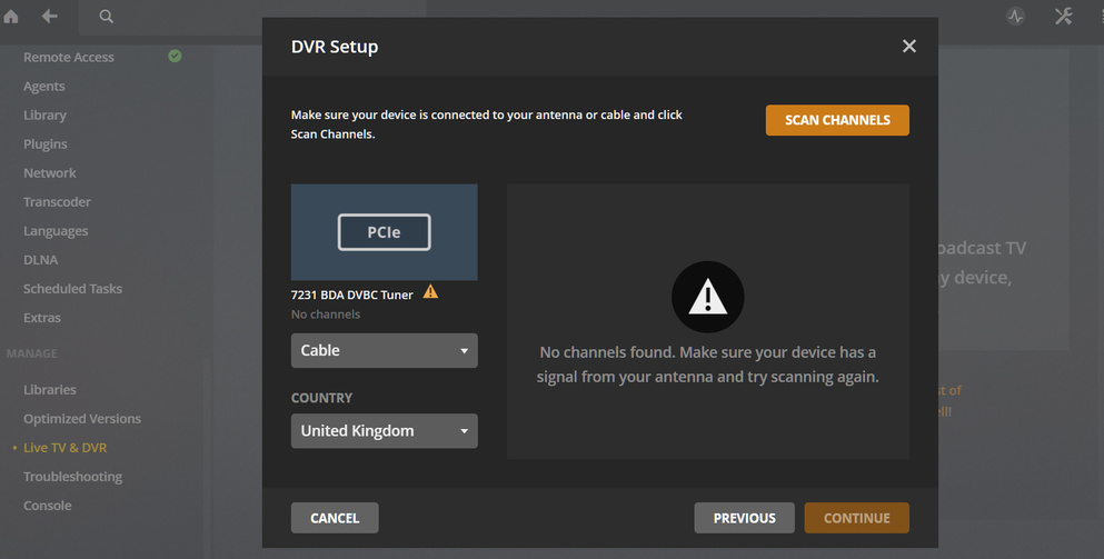

I’m trying to set up Plex DVR on a Win7 box with a Blackgold 3620 DVB-T2 (terrestrial antenna) PCIe card.
Unfortunately PMS detects this as a Cable tuner. When I run the channel scan it doesn’t detect any channels.
The tuner card works perfectly under Windows Media Center.
Any suggestions on how I can get PMS to correctly identify this as a T2 receiver and then scan the correct channels?

(yes I know convaluted) My Plex server thinks its a Cable tuner. But if you go to the next page & put in your postcode? or zipcode mine picks up the channels.
Thanks for the hint bubblegum, but unfortunately the ‘continue’ button is disabled so I can’t continue to the next screen. Maybe an earlier version of PMS would allow me to do this?
