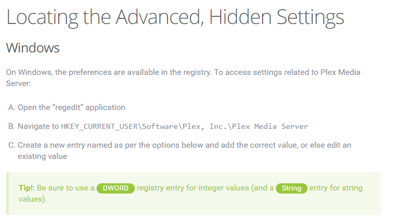

The only thing that can be done is to configure Plex to store more logs than the default 5. With all the testing I do mine is set to 100, which would be larger than a normal user would need. You can change the default using the Advanced, Hidden Server Settings page, look for the LogNumFiles setting.
I found the directory. LogNumFiles is not on the list Ran a Control F also and it did not pull up anything. Is there anywhere else i can change or access this setting?
You mentioned you were running Windows earlier. The setting for Windows would be added to the Registry not to a file. The article linked above has the steps necessary to add the setting. After adding the new Registry Key I would suggest rebooting the computer.
Added the registry entry, I think, and reran the logs. Sent to you. Thx
