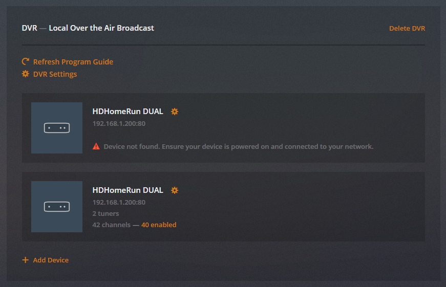

I updated my Plex server running on FreeBSD (FreeNAS) to the latest package version available which is 1.7.2.3878.
Upon starting the server back up, my previously configured and set up DVR Tuner (an HDHomeRun DUAL) suddenly said, “Device not found. Ensure your device is powered on and connected to your network.”
Just out of curiosity, I went ahead and tried to add a new device and the HDHomeRun DUAL showed up in the list of devices to add. I completed the set up steps (scanning and linking channels). Now I have two devices with the same IP and info, but the original one still says it can’t be found.
Any clues as to why this would happen? Is this a bug? Did something in Plex’s configuration become corrupt when I updated the server? Previously I was on 1.7.1.3856.
I have included a screenshot for reference. Any help would be greatly appreciated! :slight_smile:
Thanks!
No idea, but I doubt it matters. Delete the broken one, new one should work fine.
I’ve got the same issue. Updated to my Mac server to 1.7.2.3878 last night and the HDHomeRun Dual had the same “Device not found” error. I deleted it, re-added it, and today it is back to “Device not found”. Did not have this issue before the update that supports Live TV.
next time you see this, could you stop plex, trash logs folder, restart plex, if it still says ‘not found’ download logs from help menu in PMS and post here.
i’ll have a read through see if i can any see anything.
Thanks all for the replies!
As a test, I deleted the new tuner under settings and proceeded to downgrade back to the older version. The original tuner instance worked fine and did not report “not found.” This fact leads me to believe something changed in the update. Perhaps an identifier is no longer being read? (Hence why Plex wants me to add a new tuner and thinks the old one is disconnected.)

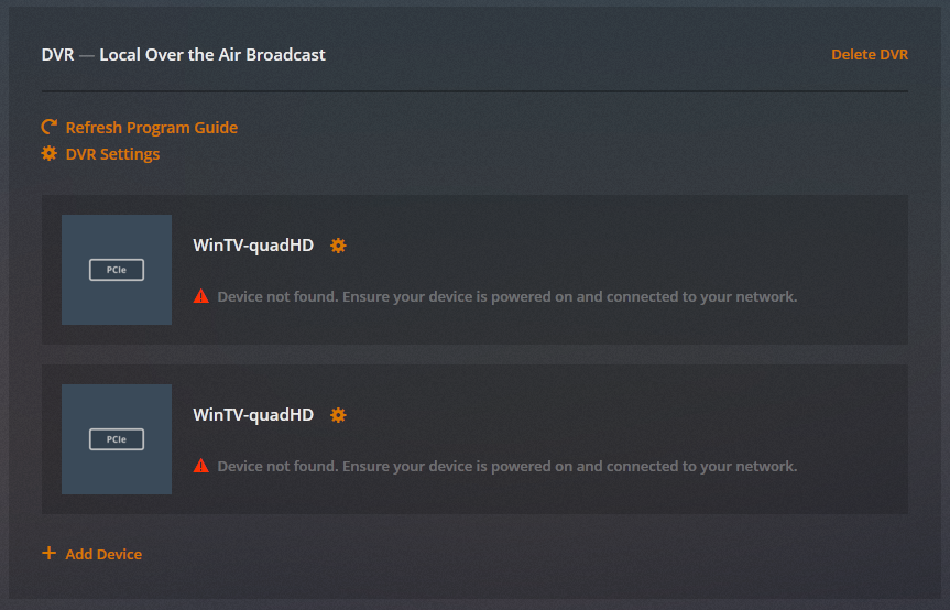

It occurred to me that I hadn’t yet tested 4 simultaneous recordings with my hauppauge quadhd. Recording 4 at once seems to work, thought I haven’t yet looked at the recording quality. But, I noticed this during the time in which all 4 tuners were in use. Instead of the usual note that says 1 tuner in use, etc… PMS 1.7.2.3910
Can we get a log of this?
keithah, I first noticed this “device not found” error when I tested 4 simultaneous recordings. But, it seems maybe the two weren’t related. After the 4 recordings were done this error didn’t go away.
The error DID go away after I exited PMS and restarted it. That should be seen in logs.

Getting the same error on the Hauppauge quad card. I mentioned this previously (somewhere), but I was running NextPVR and thought maybe that was the conflict. I’ve since un-installed that and still have the issue.
This morning, both cards were showing the error, so I waited for a scheduled recording to start, deleted one of the cards, re-added it, and that one showed up as having an in-progress recording.
So it looks like recordings are still working, even with the error message showing.

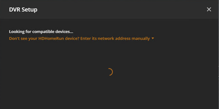

Plex cannot recognize my HDHomerun Prime tuner.
Hangs at this location.

Same thing happening here. Had the tuner installed and working properly. As per PLEX instructions, I removed the tuner from plex and attempted to re-setup so I could transfer to a new XMLTV feed. (As per Step 3 https://support.plex.tv/articles/using-an-xmltv-guide/)
Now, It will not find the tuner. Just keeps spin-wheeling me!
Pulling my hair out!
