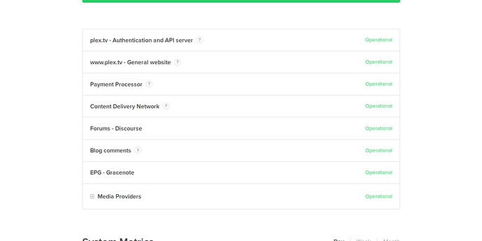

I don’t see an outage reported at https://status.plex.tv/.

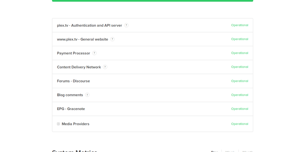

Funny, Plex seems to think Gracenote is working:

Same issue here, looks like the Gracenote EPG is not operational (despite the status page saying it is)
