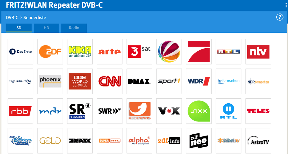

I have two other tuners calles
AVM Fritz!WLAN Repeater DVB-C
Effectively, it is the same tuner device as the AVM Fritz!Box 6490 Cable, using the same firmware (7.01 at the moment), it has two tuners.
It is connected via LAN cable to the same subnet as the router… I can ping it and I can use it as a tuner just as I can use my cable router as a tuner - but not within PMS.
The AVM Fritz!WLAN Repeater is listed in the excel sheet of community supported devices.
