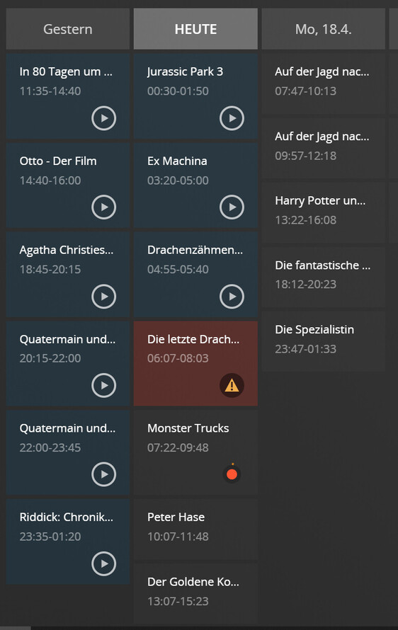

Another example:
Riddick failed (0 sek. / 159kB)
Jurassic park OK - [EDIT: but video/audio not correct synced]
ExMachina failed (8sek. / 1.39MB)
Drachenzähmen OK
Die letzte Drachentöterin failed by already started
Monster Trucks, still running.
Plex Media Server Logs_2022-04-17_07-25-45.zip (6,5 MB)
