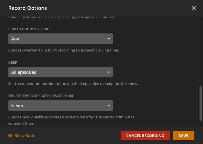

It is a new series of which this was the first episode - I have attached logs and the screen shots of the show, recording & settings.
