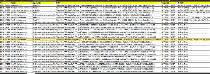

I ran the test and sent you the link to the results via PM. The link contains a text file describing the shows recorded, channel, times, etc.
Let me know if you need any additional information. Thanks!
Thanks for all the diagnostics - very good set.
I looked into detail into the recording for Nature Cat (2015) - S03E03 - Onward and Songward; Why Did the Turtle Cross the Road which was started at May 23, 2023 12:30:26
So we had a transcoder error failing to write to the file after about 23 seconds
The procmon capture shows a Network Error for the WRITE action - after writing successfully about 10Mb to the file
This is what procmon PML file shows
12:30:26.282	Plex Transcoder.exe	WriteFile
\\MCubed\Media\Test\.grab\e573a7ed0eaac332792ff0dac4892df0ce79c76f-fdd61eef7d6af2e5768e7de6f052911da4d06c55\Nature Cat (2015) - S03E03 - Onward and Songward; Why Did the Turtle Cross the Road.ts
NETWORK ERROR
Offset: 10,747,904, Length: 262,144, Priority: Normal
Filtering the PML for Network Errors - it shows quite a lot of them
So it is looking to me like a networking issue between the Windows PC and the Mapped Network Drive to \\MCubed\Media
Even Microsoft MsPpEng.exe had an error
Could you see if the Windows Application and System logs have anything of relevance round the times of these NETWORK ERRORs
Could you run some extensive network file access tests between the PC and the NAS
