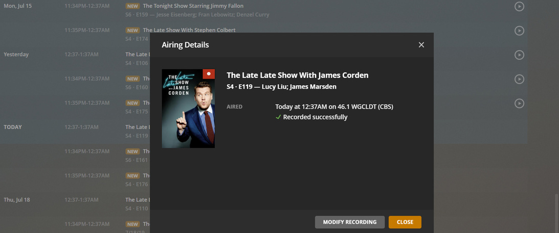

I was able to start getting recordings again by deleting any previously shows. I suspect this may have to do with retention rules. Look at the screen cap you can see that this show shows “recorded” but there’s no play icon. This dialog ONLY appears (oddly) when the show doesnt actually exist but Plex thinks it was recorded.
