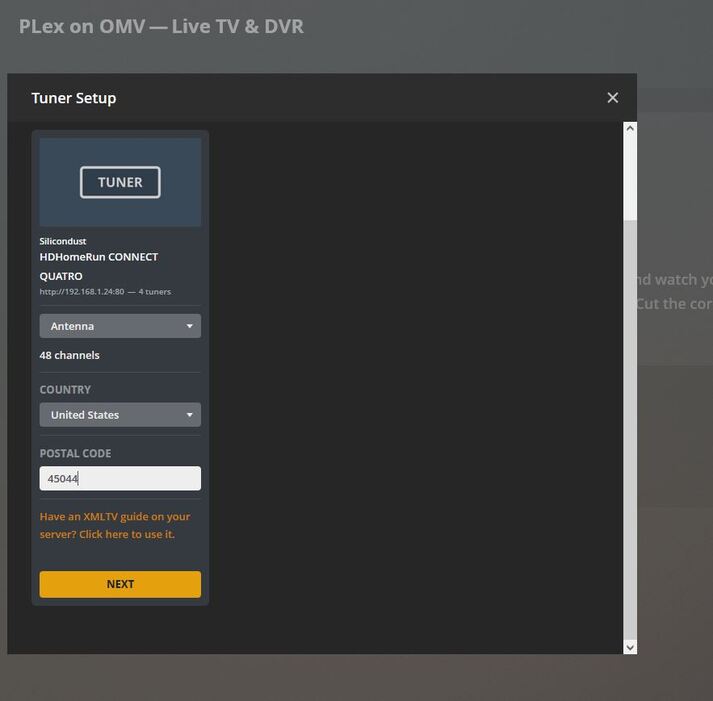

Broken for me too. I was having issues with live channels starting so decided to setup tuner once again. Now cant use live TV or DVR as I cant set it up. Zip 45044 or 45219 or any other is not working. I deleted the DVR and tried adding it back in - now I have nothing.
I have just tried US zip codes 45044 and 45219 and they should return lineups
If the problem persists please ensure debug logging is enabled on the server and then restart the server and go through DVR setup - when you get an error on trying the zip codes please get screenshots and then download the server logs and attach the zip with the screenshots
I expect the fix for the multiples in vcn numbers to get released in Plex Web 4.75 which will initially get released for the hosted Plex Web https://app.plex.tv/desktop
