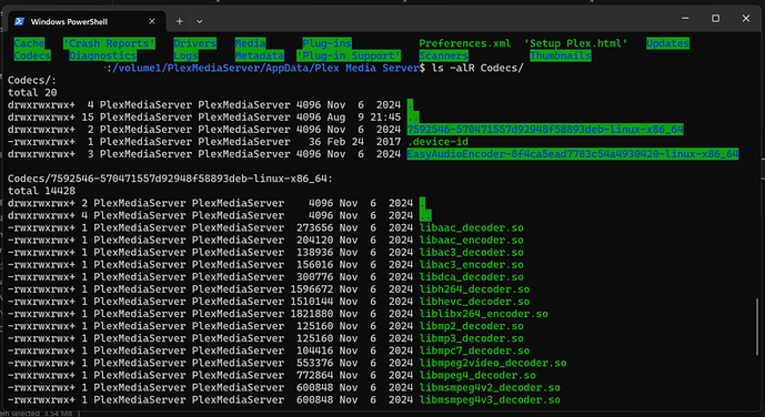

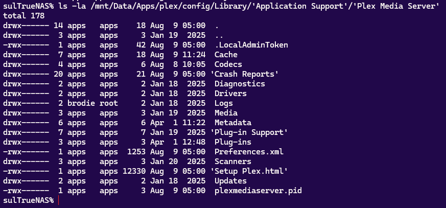

@ChuckPa I can yes, the config dir is mapped. I deleted the codecs folder and every time it recreates it, it has the .tmp and cannot change it but I can manually.
can you please show me the ls -la listing of
  • Plex Media Server
  • Codecs (get the recursive list here please)
Something is wrong with permissions. I suspect parent dir.

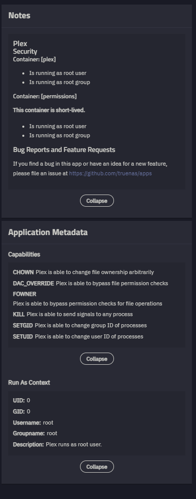

This is a TrueNAS app with all permission that are supposed to be setup already. There is a workload that sets permissions when the container is launched as shown here. I realized that it’s likely a permissions issue I am just not sure what or how. I am also not sure, if I change those, if the permission workload will change them back after.
In one of the links I posted they talked about creating a Plex user in TrueNAS, but again, not sure why that is not in the docs and not part of the permissions workload. Trying to reach out on their forums as well.
Here is other information from the app.

Edit 2! Changed permissions to that dataset for the Apps use to Full Control (to test). Still does not remove the .tmp from the codec (I renamed the folder to force Plex to recreate it). So for the Plex folder dataset the owner is apps and the apps user has full control. I will full admit Linux permissions confuse me, always have, but this seems like it should be able to rename that folder?
Edit3: I created the Plex user with 972 gave it full permission to the dataset recursively. Edited the app to run as that user and still cannot remove the .tmp from the codec. I am not going to deny that its permissions but I am out of ideas. I am not sure how the app can created the codec folder, when it’s deleted, but then be unable to rename a folder under it?

@ChuckPa I was on the Git for the TrueNAS Apps and he told me this if it help
Permissions container will only apply changes if the directory is empty. ie set initial permissions.
But Plex specifically also handles some permissions itself. But in this case it seems that the unzip program have issues setting those permissions. The container has all the needed capabilities to do so.
So its either the ACL type blocking this operation, or plex launches unzip in a way that loses the capability to set permissions (in this case the executable bit)
