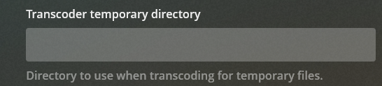

Clear out the Transcoder parameter temporarily to see if the error goes away. I would also clean up the /tmp/pms* in case you filled up /tmp without knowing.
I don’t have anything in the Transcoder directory field set (if that’s what you mean), never have:
