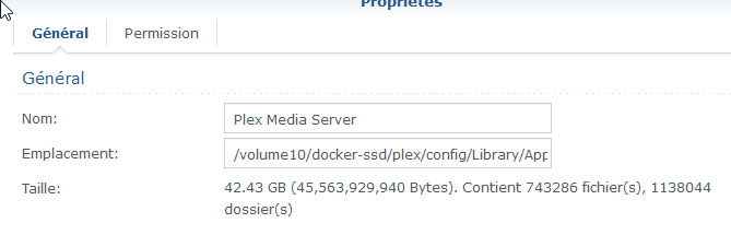

Folder Plex Media Server, 743286 files, and 1138044 folder.

That’s not the value you should base on.
find /media-directory-1 /media-directory-2  -type d -print | wc -l
Do not count the directories within the metadata structure. This will confuse Plex and lead to kernel failure. This is why media should always be kept separate from the metadata storage (/config)
