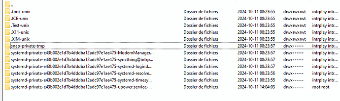

In your docker container config, where is /tmp pointing to?
never touch
/tmp

so that’s your container’s /tmp. Understood. :slight_smile:
in /tmp
