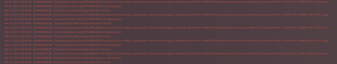

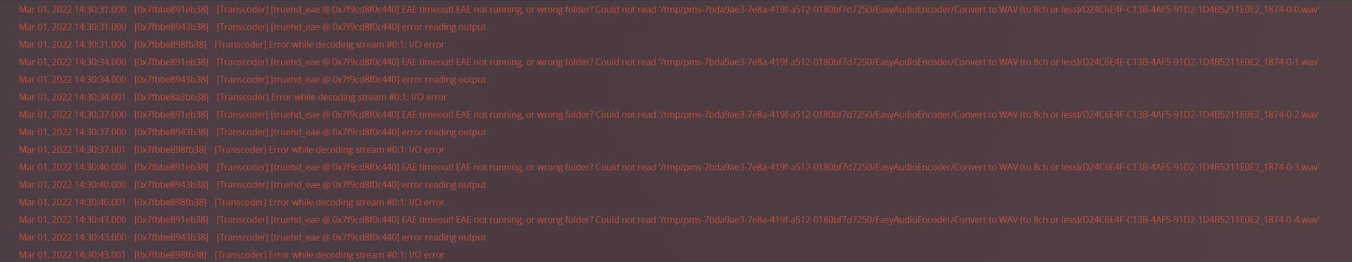

When I go to play a 4K rip on my iOS or any device that needs to do transcoding of the audio. I get constant errors about EasyAudioEncoder Timeouts because it is unable to find the .wav files it is expecting. Looking at the directory where EAE is transcoding to, I find files with a .mlp extension. If I change the extension from mlp to wav on one of those files it plays fine in VLC. It seems as though Plex might be looking for the wrong file or EAE is not naming the file properly? I will attach screenshots of the error and the files it is generating.
Well it turned out to be the common inotify issue for the linux system. I didnt think that was the issue since it seemed to be working and creating the transcoding files but I was wrong. For those running into this issue it is likely the inotify issue that is the solution to similar posts. You basically just need to increase the limit. I will provide a link to the process of doing it on Ubuntu. Thanks.
