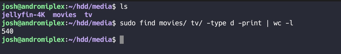

I have a movies folder with 415 folders inside, each with its movie file and a few with .srt files included. My tv folder has 22 shows, each with its own set of Season subdirectories and their corresponding episodes, most of them being less than 3 seasons’ worth. Some go up to 8 or 9 seasons.
Using the sudo find command from the article you posted, it returned 526 for both the movies and the tv libraries, the only ones connected.
Overall with 415 movies and 22 tv shows, I can’t imagine this would be enough to cripple Plex media server, seeing how people have libraries well into the thousands.

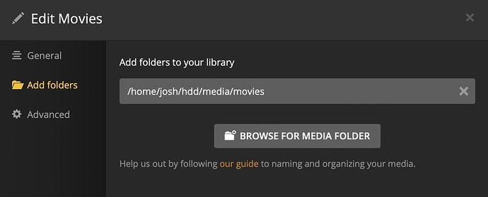

How many directories, in total including all top-level through lowest level, are being monitored ? ( > 8192 ?)
Monitored, meaning the ones that are chosen in Plex to scan for library contents? I have only two libraries - Movies and TV. In total, there are less than 550 directories within these two folders.
Those are the ones!

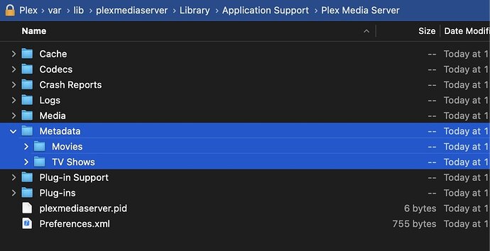

I think I’ll try to keep this build of the new server and see if the fresh setup will fix everything. Is the best way to transfer the metadata over to just copy and override the folders from /var/lib/plexmediaserver/Library.keep/Application Support/Plex Media Server/Metadata/[Movies && TV Shows && Collections] to the new server folder?
I do notice that the previous Library.keep has more Metadata folders than the new one:
So if I copy over just Movies, TV Shows, and Collections, will I basically have an identical setup as I did before?
I’m thinking I’ll keep around the Library.keep for now just in case, and maybe delete it in a month or so if everything is still going smoothly. Should I just delete the server itself without worrying about losing anything important?

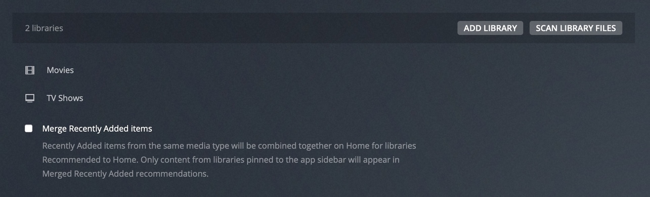

You do have collections enabled in the library settings ?
Regarding the kept server – it’s possible (not sure how much though) there’s just ‘junk’ in there from an old, now corrected, PMS problem.
As far as collections go, I have the library collections turned off and have dozens of custom collections with custom posters for many of the movies. What’s the best way to migrate those, then?
When I upgraded my server a month ago (before these issues), I copied everything from the server data directory as instructed in this article. But since has a fresh new library does that mean it wouldn’t work the same way anymore?
