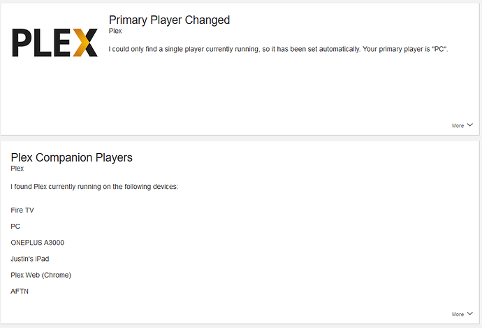

Thanks for the timely response. Yes, the player was on. Ive tried multiple different states; i.e. player on, but on the home screen. Player on, at a specific episode. Player on, actually playing an episode.
I am attempting to use my 2nd gen amazon fire tv as the player, but the echo seems to only recognize the plex desktop client. I said plex web player in my original post but its actually the windows client.
Also note that it sees all devices initially but then can only actually connect to one. Once the connection is made, the device list also becomes truncated to just one.
. As you can see, it recognizes the devices. But then it can only find one compatible player. Based on This link, my understanding is that the amazon fire tv 2nd gen is a valid companion app player for alexa.

One thing I noticed in your reply was that the system would number the results and let me pick based on number. When I was running this tests, the devices would be echoed but not numbered. The system would request me to select the default player by name.
Today I ran the same tests as I did yesterday, and all my companion apps are now available as players. I was able to set my default player and now I can control plex via the alex skill, as intended.
So I changed nothing, but it started working! I will assume I got some update to the skill that fixed it. Because as you can see based on the screenshot above that my attempts yesterday were fruitless.
