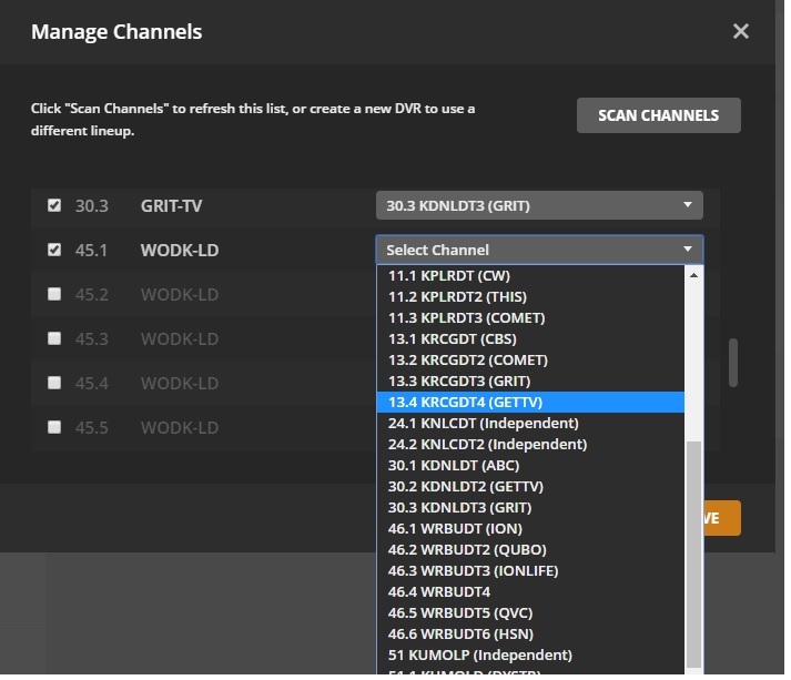

There is a. bug in your dvr channel selection setu.
once tuned it will not enable some channels, even if i tick them off and assign them to valid epg entry.
when i save and go back the settings are as before , only 25 cannels enabled out of 33. theres no way i can get the other 8 to work. ive also tried deleting and adding the dvr again but it will only enable the same 25 channels. any ideas?

No,
the problem is that there are 38 channels available in the hdhomeun tuner.
I CAN see them all in the plex dvr setup interface. But out of all channels i can only activate
25, the other 13 do not save even if i tick the checkbox and assign a valid epg entry.
After i click SAVE, plex web has still only 25 channels out of 38. I’ve tried saving dozens of times
with no success. Its becoming frustrating. The 13 channels I can’t save are always the same ones.

As was requested by @kamererhouse can you provide a screenshot? Can you also verify that you can actually view live tv on the channels you are saying you can’t save. Simply seeing them in the list does not indicate that they can be viewed and actually have a signal.
@kamererhouse unfortunately a screenshot does not really show the problem
below is a link where you can see a short video of the issue demonstrated.
1drv.ms/v/s!ArGTYJTGXumxlDTrqj3ei6xRQg7y
