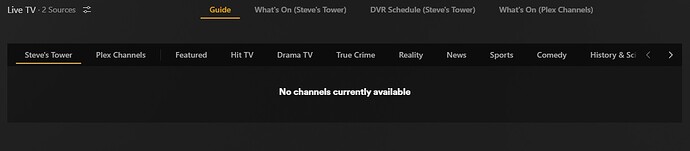

EPG fails after a while
I am trying to load EPG from ErsatzTV. It works… For a while… Then I get the error “No Channels Currently Available.” I go in to Live TV Setup and see 2 channels (9 enabled). I don’t have 9 channels. I did – a long time ago – but I don’t now.
When I click on “9 enabled” I see 7 blank channels and the two I want to map at the bottom but not mapped. I map them and save. And everything works…
Until it doesn’t… and I have to do this whole process all over again.

I will happily provide full logs but I can’t figure this out. I take ErsatzTV out of the equation and run just my HDHomeRun tuner using native EPG downloaded from my zip code and same results… works for a while… then always back to “9 enabled”
Have you tried deleting ErsatzTV as a source and then adding it back in, starting from scratch?
Yes. I’ve even deleted all tuners from the database manually. I’ve added just my HDHomeRun which has 40+ channels. No matter what tuner I use or how many channels it always fails back to 9 channels. Something is buried in the system somewhere that knows about the original 9 channels I had from years ago.

I have done both of these things to no avail. The channel mappings are stored somewhere else. Media_provider_resources only stores the actual tuners themselves. tv.plex.providers.epg.cloud – don’t know what else it stores besides EPG data… But it doesn’t store mapping data.

Again, the EPG isn’t the problem. The MAPPING between tuner channels and EPG channels is the issue. When I do the mapping manually everything works fine… Until something happens in plex and that mapping is overwritten. It seems like plex is just “recomparing” the mapping.
But, to speak directly… I have uninstalled ErsatzTV. I’ve changed the IP address, changed the UUID, set up firewall rules to allow ANY traffic from Plex to ErsatzTV (just in case there was a firewall rule I didn’t see).
Something inside Plex is holding on to the fact that months ago I had an xteve source with 9 channels. Every tuner I try, regardless of the number of channels presented, always goes back to “9 Enabled”

I think I may have figured it out. Apparently I still had a disqueTV instance running and, unbeknownst to me, this thing ran something hourly that messed with plex’s guide. I stopped that container and the guide has been solid for 1 hour and 49 minutes so far.
DisqueTV was not supposed to interact directly with the Plex EPG at all… apparently it does. Will keep this thread up to date after several more hours.
