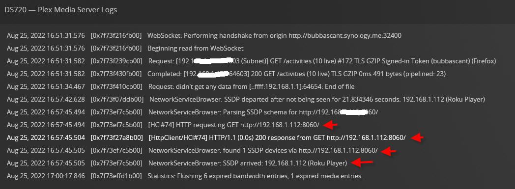

My A/V guy is asking why you were asking about the device at .122.
Can you clarify for me why you asked? And what you’re seeing on that device? And did that have to do with my question about the audio playback delay between tracks? (Playback on Sonos via Plex or just using Plex app on iOS devices does not have the delay - it’s only on the desktop Plex app), or was it from something else? Was it the screenshot I sent? Not sure about things enough to know really what the log results mean.
Is it a concern is some way? And why? And what should we do about it?
Can you let me know so I can let him know.

My apologies. I just posted a few questions for you related to your mention of the device at .122, etc. I didn’t see that you replied last night (I don’t recall seeing another email notification). My apologies. Basically my A/V and network guy is wondering why you asked, what you thought it meant, and so forth.
I also asked if I needed a new certificate for plex for Synology after updating my password. You did reply on my password question (I updated through my account), but still wondering about the certificate.

1. Addr 112
I was referring to the x.x.x.112 address you show here
What I missed, for which I apologize, it it identifying itself – Roku Player
(it’s been a long, busy, and tiring, few days)
false alarm.
please accept my apologies.
