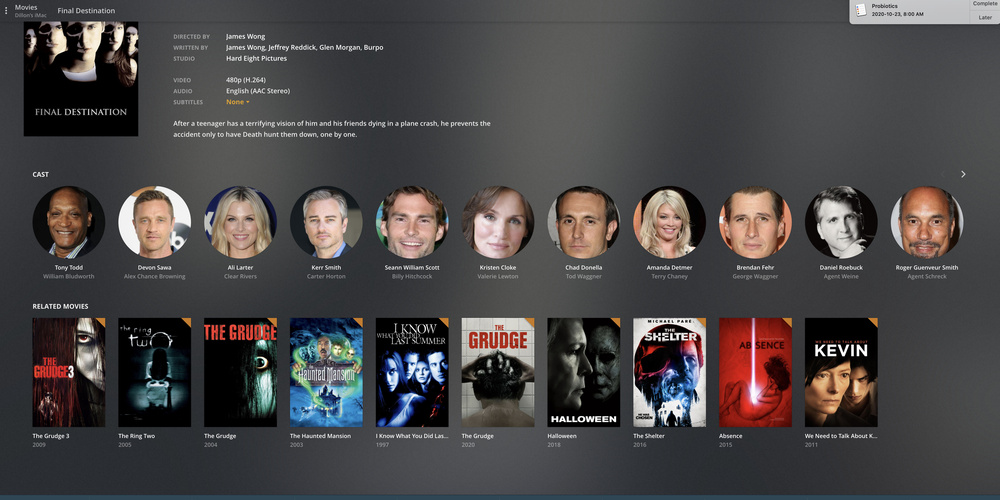

I’m not sure what I’m doing wrong, but I can’t get my extras to show up in the Plex MS. I have tried nesting the file within a folder and also leaving it in the main folder, but that doesn’t work. Any suggestions?

Thanks for the ideas, but they didn’t work unfortunately. Here is an updated version of the files and what I see in Plex:

Thanks, I was able to get it to work perfectly on my side using the exact same structure as in your first screenshot. I’m not entirely sure why it’s not working for you.
Could you try remove the entire “Final Destination” folder out of your main movie folder, scan the library and wait for it to finish then move the movie back to your movies folder and scan again and see if that helps at all. Honestly a bit stumped as to why it’s not showing up for you.
Super strange! I just tried that and it didn’t work. Is there a lag possibly? Should wait longer to see if the extras will just show up?

Thank you for the suggestion! That didn’t work either sadly, but I might just move my extras into a separate library instead. Might be easier. Thanks for all your help!
