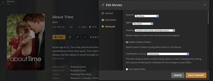

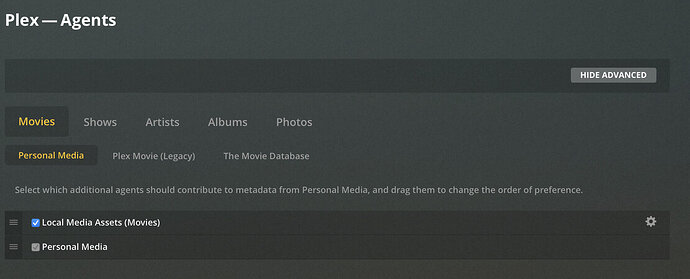

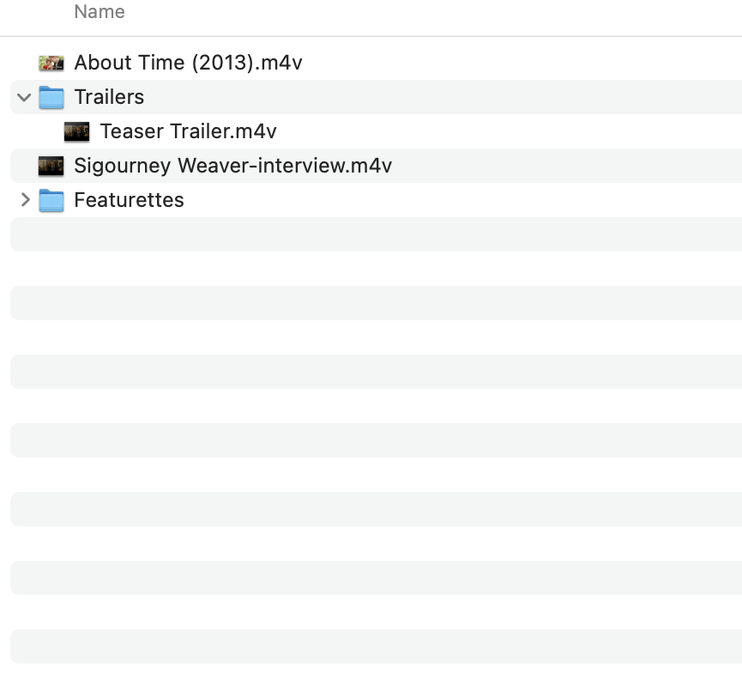

In an attempt to debug, I copied and pasted an example, verbatim. I put a file in sub and main. Hopefully, one of them would trigger. nothing thus far. Ive shared some screens below. Do you see a problem or typo that I don’t?

  1. I copied and pasted the example for both ways from the literature into my setup in an attempt to get them to show. nada.

I suppose all those files are in a folder named About Time (2013)?
The files themselves look ok.
Given your library is set to use the Plex Movie agent, all configuration is done in the Advanced library configuration (Edit dialog from your final screenshot).
Have you enabled Use local assets on that library configuration?
If the files are not showing… can you double-check if there’s embedded metadata in your extras that might throw Plex off? (on a Mac you can e.g. use Subler to check that)
Yup, they’re all in that folder. verbatim. Local Assets are enabled.
I copied and pasted said extra to a different movie. It pops up fine when I moved it…
