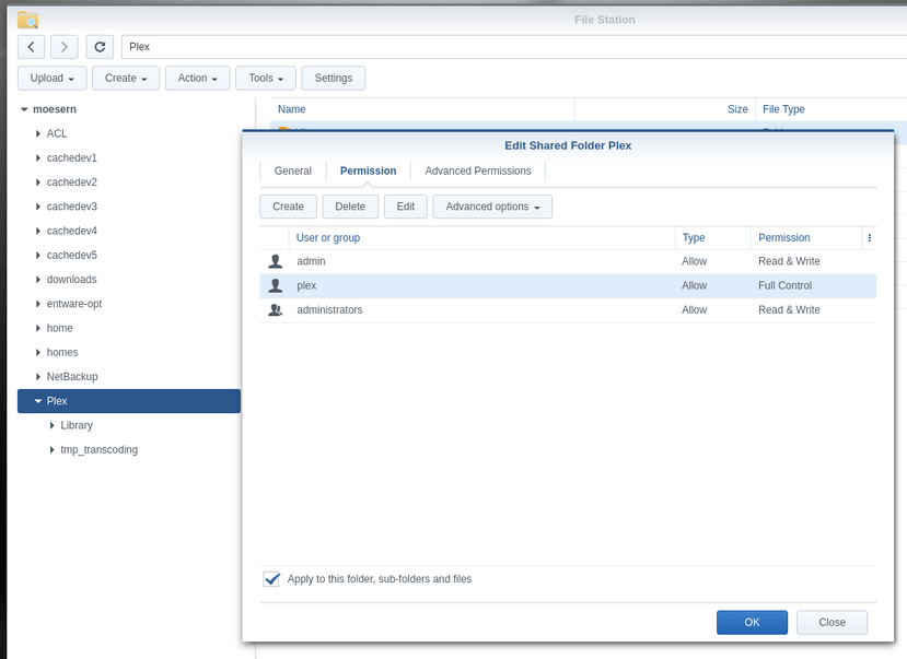

First and foremost are the ownership & permissions in the Plex shared folder.
If we get them right, It will start.
  1. The Plex share
    a. File Station
    b. Left Pane
    c. Right click Plex
    d. Properties
    e. Permissions
    f. Plex has Full Control
    g. Apply to this folder, sub-folders, and files.
    h. OK – and wait for that to finish
    i. Right-click “Library”
    j. Properties → Permissions
    k. Verify owner is plex
    l. Apply to this folder, sub-folders, and files, Click OK.
Let’s give that a spin.
