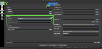

When I tried to use mkvtoolnix this morning, the screens that appeared on my computer are not the same as the screens shown in the instructions for the software. Perhaps the problem is that my Mac’s OS is 10.13.6. In any event, I will try something else. Thanks again for your help.

The underlying features should be the same… the look and feel of the app might be a bit different on various platforms (and changing over time).
After selecting the Split mode, the next field has a detailed tooltip on what parameters are expected/allowed/possible.
Hello to all. I found a tutorial by EposVox, who put me on the right path with mkvtoolnix. The split files are looking pretty good now. Thanks for your help.

  2. Mkvtoolnix will perform actual remux (multiplex) and allow tracks to be added, removed, samples taken, as well as reordering the streams during the filtering process… and it’s fast. It does not alter any stream contents, it works using timecodes and stream ID only.
