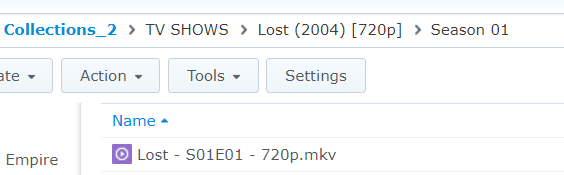

yes i did the Y:\TV SHOWS and as i mentioned above only the files under lost 1080p are getting picked up(all seasons are fine) but the moment i put in the 720p folder they dont work. I even tried putting the 720p episodes in the already existent folder which is getting picked up with the same working name convention
Lost_S01E01_x265_1080p_BluRay_30nama_30NAMA - 720p - new file
Lost_S01E01_x265_1080p_BluRay_30nama_30NAMA - working file
i was thinking that might be the issue and changed it as follows. Normally many of them dont have an issue,. i was not able to play the 1080p files on my firestick 4k so had to get some 720p files

i just followed your message and named it as follows, but when i rescanned plex dont see the file
As mentioned above is it due to multiple files of the same show in different formats?
Did you change the folder in the library properties to just Y:\TV SHOWS?
it never changed, i removed the one which you pointed out as i was trying something, its always been Y:\TV SHOWS as others were getting picked up

yeah like one of the moderators mentioned, i did the plex dance and created the folder once you gave me the instructions. yes they are on synology nas, i can access them both from a network drive and browser as well

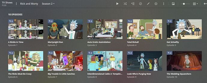

You should end up with something similar to this screenshot when you navigate to a season for the show,
The little blue “2” indicates there are 2 versions of the file. I believe every player has an option to select the version you want to play, and some will do it automatically. The indicator should also show up in “On Deck” and “Continue Watching” on the home screen
yes i see the blue absolutely and i thought the same when it all started, but unable to find the two versionsimage
yes on the home screen, i can select play version and can select… now i see them… looks like the file naming convention has been always showing the blue and 2 files but i didnt know how to play them, this helps now… have to try it on firestick 4k
