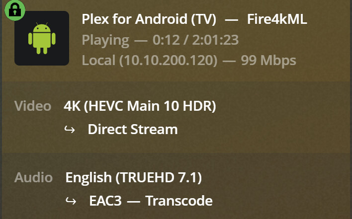

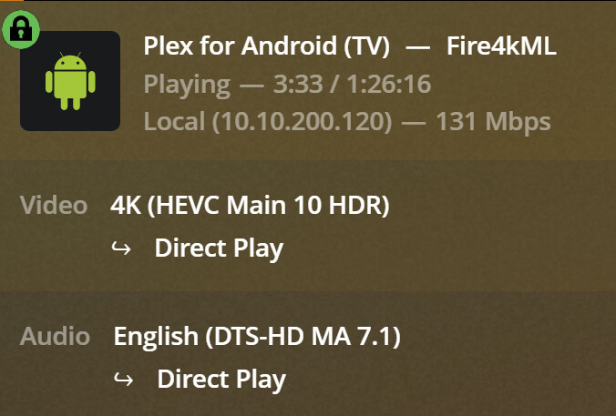

So I am not finding this the case.
The video that does play in plex under the dashboard I see this:
The video from my example that does not play properly I see this:
Both video’s I posted the media spec which are both higher than the firetv 4k spec posted.
Anyway I am not seeing the connection with why some video play fine and others do not.
