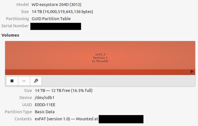

@ChuckPa I think I may find the problem: the partition of my external drive breaks the new movie scanner (but still works for legacy scanner).
My current partition on existing two drives: they have Partitioning: GUID Partition Table, but only one exFAT partition. I don’t remember whether I deleted the EFI partition so it become like this.
The file in the main disk of my machine works for new movie scanner. And I grab one smaller drive and format it on Ubuntu directly, that drive does not have any partitioning, only a single volume. And it works under new movie scanner.
My plan is to reformat my large drive and see how it works. It is very wired that legacy scanner works on all these drives. So I think there are definitely something changed in new scanner makes it not compatible any more.
@ChuckPa I reformat my 14TB drive but it still does not work. And I think I found the problem: New movie scanner can not scan large drive! I think large means “>=10TB”, I only have 4TB, 10TB and 14TB (latter two do not work), not sure whether it works on 8TB. I am using connect all my drives to machine directly, not NAS or raid.

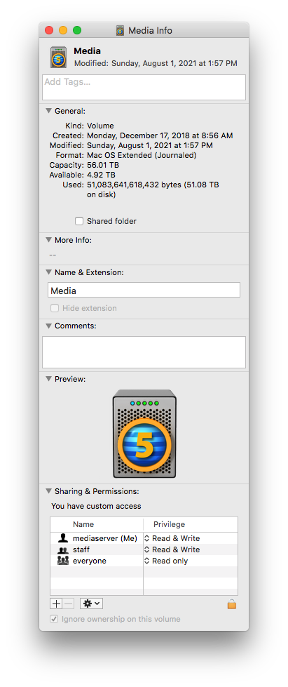

If I may, exFAT is great for transporting between OS’s but not great for everyday storage on macOS in my experience. Unless Apple has made that driver much, much better. I use some 2TB and 4TB drives to transport files between macOS and Windows all the time without a problem.
My main Plex server is a MacMini with a USB connected RAID volume as follows:
Screen Shot 2021-08-12 at 11.20.09 AM
And Plex finds every movie, tv, and extra file I have.
Chris
