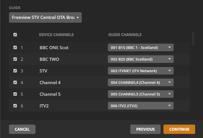

The “Freeview Scotland (Border) OTA Broadcast” lineup, labels
02: BBC2 as BBC Scotland instead of BBC Two (as I said previously, it’s just the national channel now).
102: BBC 2 NI HD. Northern Ireland? Really?
It actually appears that the BBC Scotland channel does exist in the EPG, it’s called BBC Scotland - but it’s been stuck at 002 instead of 009 and 115 for the HD version (and means BBC Two National - which should be at position 002 and 102 as the HD version is missing)
Same issue as asjmcguireplex but with ‘Freeview STV Central OTA’
But channel 3 (STV) seems to be wrong, doesn’t match the guide, the hdhomerun dvr got it right.

Just tried Freeview Central (West) OTA Broadcast, I’m based in the West Midlands UK, and the guide looks much more promising than previously, with a lot of incorrect channels adjusted. However, here is my list of issues (most of which have probably been mentioned already), but just for reference:
13 - E4 - mapping shows Channel 4 not E4
32 - Sony Movie Channel - only shows ‘Sony Movie Channel - UK Programming’, no actual listings
39 - CBS Justice - mapping shows CBS Action +1 not CBS Justice
42 - Home - only shows ‘Home (Freeview) Programming’, no actual listings
54 - Paramount Network - only shows ‘Radio Programming’, no actual listings
55 - 5Select - only shows ‘Channel 5 Programming’, no actual listings
72 - YourTV - only shows ‘Unknown Airing’, no actual listings
83 - Now80’s - no mapping
84 - Now90’s - no mapping
91 - PBS America - only shows ‘To Be Announced’, no actual listings
93 - Travel XP - only shows ‘To Be Announced’, no actual listings
96 - Forces TV - only shows ‘Forces TV Programming’, no actual listings
99 - Smithsonian - only shows ‘Radio Programming’, no actual listings
I’ll submit them via the form too. As a note, this is on the updated 1.16.1.1273, which DID require a full refresh to remove the E1 issue

All the mapping issues listed were fixed by Monday - if not please let me know the post code and which channels remain on wrong number or not available. The DVR needs to be deleted in server settings and recreated to pick channel changes
The 54 Paramount channel issue where the EPG is 1 hour out has been referred to our provider
