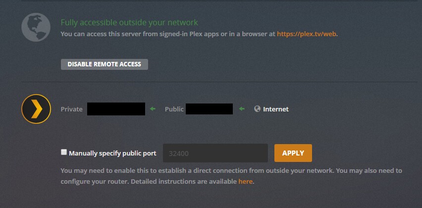

So it says my remote server is fully accessible outside of my network, but I am unable to access it on my phone or tablets on 4G. Tells me the server is unreachable.
What am I missing here?

For some reason they’re pushing virtual network addresses at us instead of publishing our real addresses. this is happening on my shield and windows boxes, so far my freebsd box is ok, but I also have plex-relay disabled there.

still flapping back and forth between that reserved network and my address, the good news is it’s not really down. you can connect to external-address:port directly, it’s just that plex clients can’t find you as they rely on the website to tell them where to go.
I got sick of it and ended up downgrading mine from the new 1.13.8.5395 back down to 1.13.5.5332. As soon as I did that my remote access issues were resolved.
Looks to be a new bug in the new code? and I would agree that it likely has to do with pushing virtual IPs.

Downgrading to 1.13.5.5332 did not work for me unfortunately, I have tried everything I can think of. Everytime plex shows “Fully accessible outside your network” the Public IP is 172.17.0.1, which is not my public IP, nor is it in any range on my local network, local ranges are 192.168.7.x and 192.168.0.x. Plex remote access was working perfectly until I got Plex Pass and added a user to my home. Makes 0 sense since that has nothing to do with the network settings. I changed nothing, the port is open from outside in and inside out. I think Plex is defaulting to the wrong Public IP.
