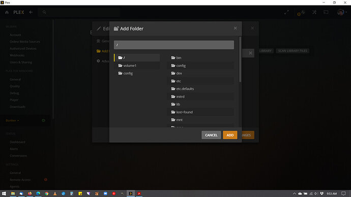

Thanks. I got it running kinda, mainly by updating the the Synology operating system. I’ve created the server on Plex, and computers on my local network can see it. However, they have no content. When I go to manage library I’m asked to select folders…
So I go to Volume1, scroll down and find the folder my music library is in…
But after all that I’m still told the library is empty. What am I missing? I already had the music in folders on the NAS, so I pointed Plex at those. Is it somehow necessary for the media to be in the Plex folder?
As mentioned earlier, do not put any files in /volume1/Plex. Doing so will cause problems and Plex will not function correctly. That folder is reserved for Plex Media Server use. There are warning messages to the same effect in multiple languages in /volume1/Plex.
Your movies/music/etc can reside in any folder except those mentioned in the setup document and FAQ (i.e. not in /plex or Synology folders such as /video).
Plex does have requirements about how media is organized within a folder.
For album oriented music, content should have each artist in their own directory, with each album as a separate subdirectory within it. Example: Music/ArtistName/AlbumName/TrackNumber - TrackName.ext
There are similar requirements for movies and TV shows.
Plex naming & organizing requirements are listed in Plex DocumentationYour Media.
Review the section on music files and adjust a necessary. Write back if it is still giving you problems.
