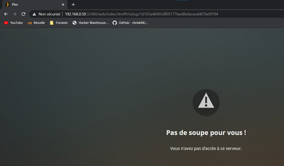

When i launch the server for the first time I havn’t the “How it works” page. A message it’s display “You have not access to this server”.

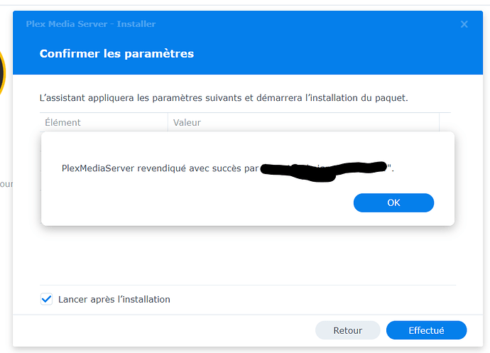

-Use claim token (the ID who claimed is the same than the ID of my plex.tv account) :
The server stay not found :
I appreciate the GUI was multi-lingual ! (You could see the screencaps are in french, sorry)
This is the log file about the new install with claimed token : Plex Media Server (3).log (494.5 KB)

Regarding the “no soup” , this is telling us that the account owner credentials do not match the credentials of the username accessing it – or – user authentication is not working.

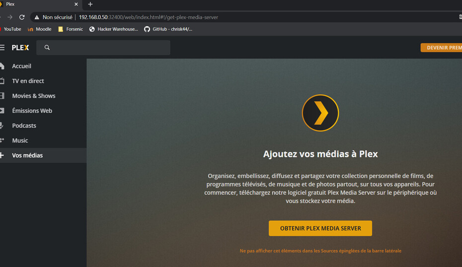

That’s how my NAS appear in my plex.tv account :

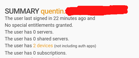

I have checked your account.
  1. I find the Plex.tv account for quentin . I see no servers registered there.
  2. I do not find an account for toto@contoso.com.
Are you certain these are the correct credentials ?

It’s clear that your DSM 7 system is not contacting Plex.tv using this account.
I am very concerned because:
  1. When PMS states “PlexMediaServer has been claimed for XXXXX”
  2. This is confirmation the server entry exists.
  3. Checking the account again shows me:
    Screenshot from 2021-04-20 11-03-50
Are you 100% certain you used the correct account ?

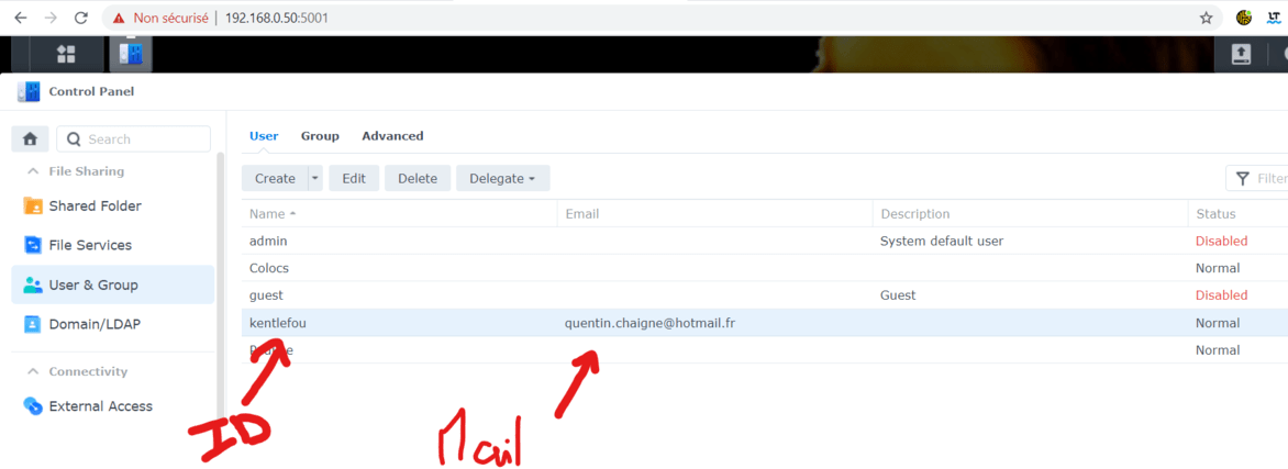

Here are my local accounts :
The mail setup is the one I used to create my Plex.tv account.
This the right way ?
(Thanks for your time)
Correct…
your Plex account is what you use for everything related to Plex.
You use the Synology account to sign into the NAS.
From that point forward, you use your Plex account.
