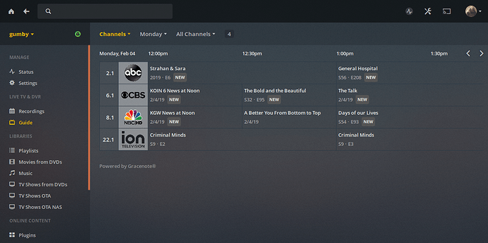

I just checked my guide data and not only am I getting Unknown Airings but channels disappear after today.
Version 1.14.1.5488 Ubuntu 18.04 LTS
And after manual refresh of EPG:
Plex Media (3.7 MB)

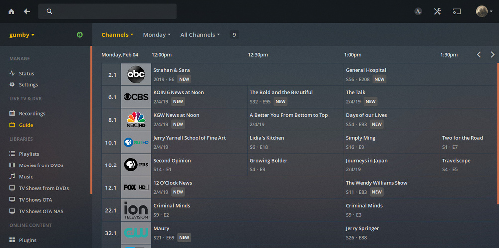

Just checked my one server this morning and everything after midnight is a problem. I switched my second system to use Zap2XML and import the listings nightly and it seems to working correctly.
After manual update, listings are correct.
Still nothing from Plex.
Plex Media (3.4 MB)
