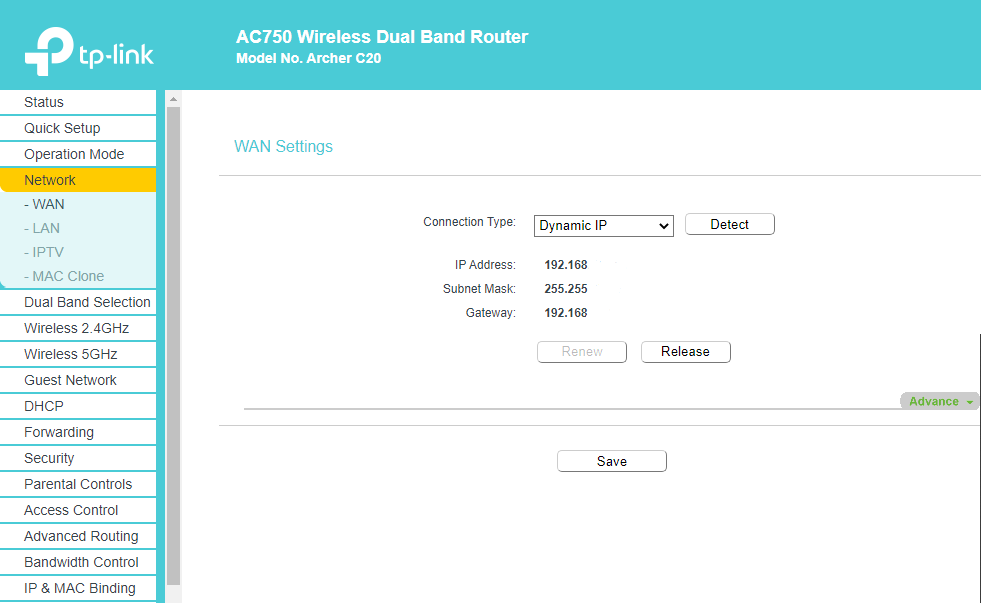

Can you check your router to see what you got on the “WAN” side ?
Please print the first 2 numbers of the IPv4 address.

In the first image i covered my IP address, Subnet Mask and Gateway. If u want to know it, just tell me.
@marekmikan1999_gmail_com
Thank you… 185.x.x.x is good enough. It confirms your ISP is not creating an artificial private network before it gets to you.

So indeed, there is 2x NAT and that is the reason why (direct) remote connections do not work.
Ideally the 185.x.x.x would be on the screenshot of your home TP-LINK “WAN” section like you showed. But now it says 192.168.x.x (=RFC1918) so there is 1 additional router in the chain, which you seems not to control and THAT performs the final translation towards the public 185.x.x.x
So yeah, if you cannot find out who controls that other router carrying the 185.x.x.x the “direct remote access” will never work.

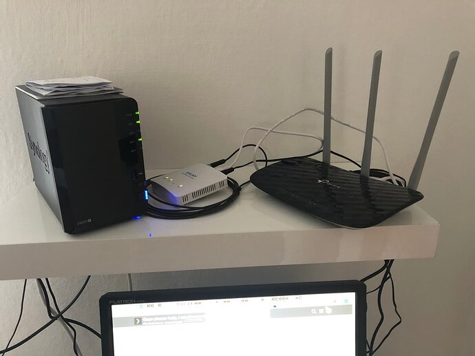

yes it can be as you described it. My router and modem + synology looks like this.

What is that beige box? Is that your modem/router from your ISP ?
If so, what make & model is it? I’ll look up the user’s manual.
That small white box is a HALNY GPON ONT unit. So from there using UTP-copper to the T-LINK.
The ONT-box is a L2-device, so its for sure not responsible for the double-NAT.
Then basically I think you’re doomed in the sense that your ISP performs a NAT again on some central boxes. Nothing you can do about it (except change ISP) and Plex Remote Access “direct” will never work.
