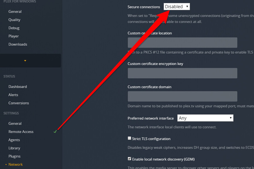

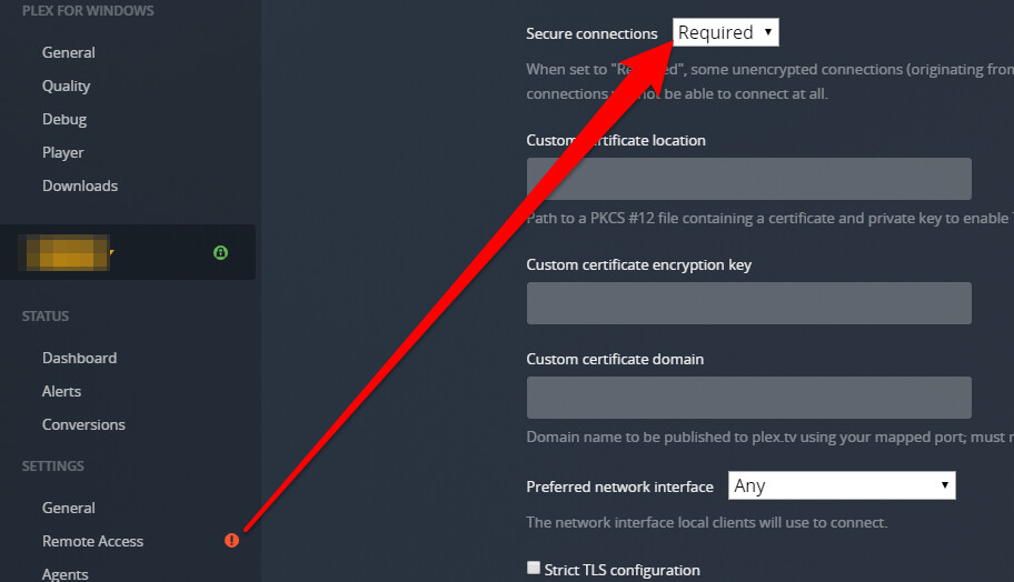

Same for me, it seems if I disable Secure connections its fine.
To add to this, if I leave it as secure on my LG TV cant connect to the my local Synology NAS, but I can access plex remotely from my phone on 4G.
