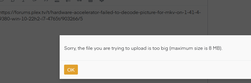

Can you share one of these files with me over DM?
yes, but itll be a 5GB file though!

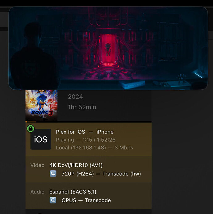

Hardware encode works but not hardware decode.
Does hw decode work on a file which is not av1 encoded?
